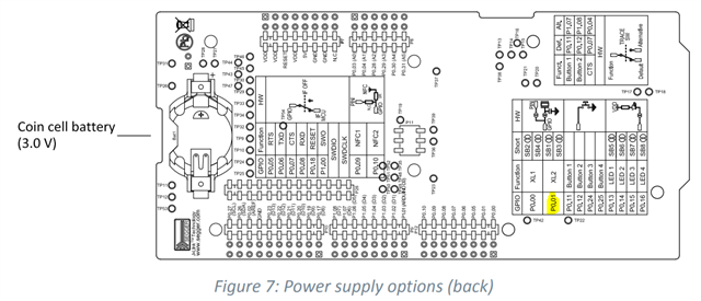

Can't override pin assignment in .overlay
I'm trying to declare custom GPIO on pin that are already used by the default dts of the nRF7002-DK. I'm currently testing on P0.11 that is used by SPI4.
My code is quite simple and toggle a LED, a custom GPIO no used by default and a custom that is already used by default. Only the two firsts are effectively toggling, the custom GPIO that is used by default remains at 0. I tried with several pins and the result is always the same.

Has anyone got stuck on a similar issue or im I missing something somewhere ?
Thank you
    You may need to modify the pinctrl node to remove spi4's references to those GPIO. Please check the generated zephyr.dts in your build folder to see if references to pinctrl groups like "spi4_default" or "spim4_default" exist. If so, you will need to delete the pinctrl group nodes from your .dts overlay.
    Helmut Lord
  • Thank you.
    I indeed had mention of spi4_default and spi4_sleep in the zephyr.dts. I deleted those nodes in my overlay but P0.11 still remain at 0.

    [EDIT] : I just tried with pin P0.22 that is normally used by uart0 and it seems to works fine. I don't understand why it doesn't with P0.11.

  • Hi ,
    I had the same problem and was able to solve it with other pins (I was using the pins marked on the bottom of the board). I read a thread that mentioned it.
    I switched from P0.01 to P0.17.
    Tania
