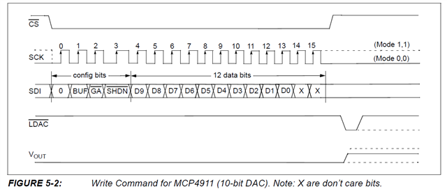

SPI word size in Zephyr
I'm using Zephyr with SDK v2.3.0.
I'm using the Laird BL652 BLE module (with the nRF52832)  on my board, which comes with a nice device tree that includes a setup for spi0:
&spi0 {
	compatible = "nordic,nrf-spi";
	/* Cannot be used together with i2c0. */
	/* status = "okay"; */
	cs-gpios = <&gpio0 22 GPIO_ACTIVE_LOW>;
	pinctrl-0 = <&spi0_default>;
	pinctrl-1 = <&spi0_sleep>;
I've added an overlay that moves the CS GPIO to number 18, which is what my board uses:
&spi0 {
    cs-gpios = <&gpio0 18 GPIO_ACTIVE_LOW>;
    status = "okay";
However, the slave I want to talk to needs a 16-bit word size and I can't understand where to set that in the device tree or at run-time. Maybe the default is 16-bit, but I can't find where that's specified either.
Bret
