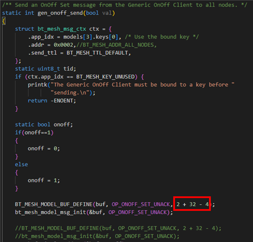

      I have three nRF52840 boards and have been running the examples MESH and MESH-PROVISONER(nRF Connect SDK 2.1.2).One provisioner and two nodes.

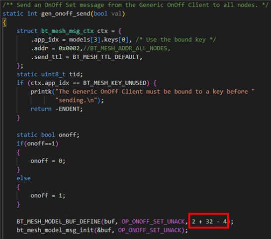

In the mesh example, I'm attempting to modify the size of the buffer, as shown in the diagram below. When it's set to 32 bytes, the information can be transmitted successfully. However, when the length exceeds 32, it displays an error message in the serial information, saying "message too big." I'm wondering if there's a way to expand the size of the message.If I want to transmit a 256-byte data through the mesh network, how can I achieve that?

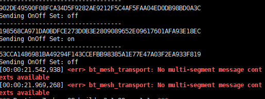

When I use a button to control information transmission, such as pressing it once to send an "on/off" command to the target node along with a segment of data, I encounter the following err  when I quickly press the button twice (with an interval of less than 500ms), as shown in the diagram below. What could be the issue here? Is it possible to minimize this interval time as much as possible?
    For that I recommend having a look at the custom Chat Client model used in the Bluetooth: Mesh chat sample, as that one is already made for sending longer messages. The generic on off model, which you build on, is a SIG defined model which is intended for messaging one bit of information (either "on" or "off"), so I would expect the implementation to have restrictions on message length.
    There is a restriction that you can only send one segmented message at a time, to the same address. So if you already are in the process of sending one segmented message, you must wait for the message to have been sent before you send the next one. Accounting for 10 packets per second (on average) or 100 packets in one burst (then waiting for 10 seconds after the first packet sent before one can send another one), you will see that sending long messages may take some time. I am not 100 % sure if this is the reason for that exact message, though.
