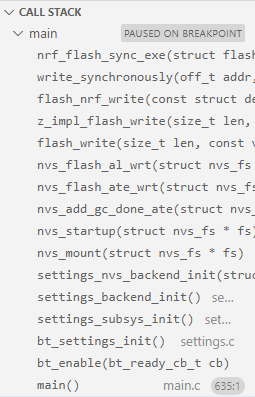

The program downloads and runs in the board, but it resets after reaching the line
ret = mpsl_timeslot_request(_context.session_id, req);
The call stack is this:
Thank you again
Renato

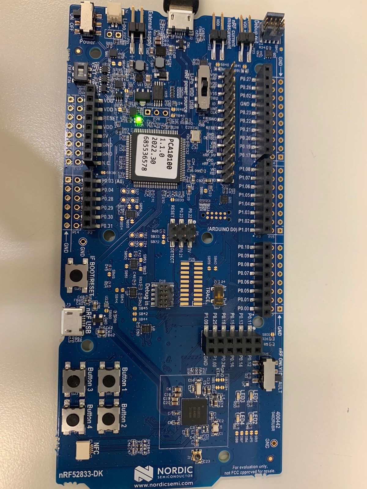

Could you let me know what the version and date code on your DK is, printed on the white label?

I only have this board. I am not sure which number is the version and date code, so I am sending a picure

But the good news is: I managed to make it work! Because the problem is a Data Access Violation, I was thinking that the call stack was very deep and maybe the stack size was not enough... so I increased the main stack size from 1024 (the default value) to 2048 and it worked!
Then, returning the stack size to 1024, it still works because the program doesn't call nvs_add_gc_done_ate(..) anymore. However, if I erase the flash with the command "nrfjprog -e", then it fails again because it tries to run nvs_add_gc_done_ate().
So basically, when the program executes nvs_add_gc_done_ate() with a main stack size of 1024, a Data Access Violation occurs. Increasing the stack size to 2048, the program works.

A good old stack overflow then. I should have been suspicious when you shared the call stack earlier, it was pretty deep after all.
