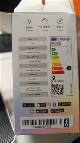

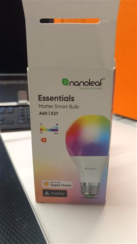

              5) I'm having nanoleaf Matter Bulb A60
I'm trying to commission the light bulb using the chip-tool, OTBR in docker but I'm getting following error :
