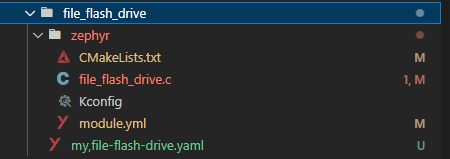

Yes, I just created it "my,file-flash-drive.yaml" , but how to tell build system where to search for this file?
description: | Raw flash storage emulation based on a single file in FAT-FS formatted SD card compatible: "my,file-flash-drive" include: ["base.yaml"]
list(APPEND DTS_ROOT ${CMAKE_CURRENT_SOURCE_DIR}/src/file_flash_drive)
list(APPEND EXTRA_ZEPHYR_MODULES ${CMAKE_CURRENT_SOURCE_DIR}/src/file_flash_drive)

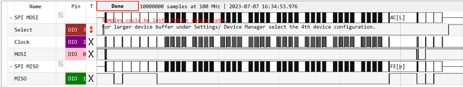

However, fs_mount returns -5, (f_mount returns -13). After some debugging with logic analyzer and oscilloscope I found that the f_mkfs() returns 0, but during f_mount() which is called after f_mkfs(), the received 512 bytes of data are all zeros. I think its incorrect, dont know why there are all zeros instead of first sector data for FAT32. I use 32GB microSD SDHC Class 10 card inserted to "Nordic internal debugging interface" after small SMD additions to it (added pullup resistors to VCC, disconnect card's DAT2 and connect CMD to its pad on the PCB, and also changed dts file accordingly. The card can communicate, and return correct nonzero CRC, can receive commands and send command execution status codes, but the data of the first 512 bytes is 0 after formatting.
Here is the logic diagram of first 512 byte sector reading during f_mkfs:
UPD: This was a hardware issue. I didnt switch SW9 on my DK, which selects between 1.8V and 3V for logic voltage which also used to power SD card. For SD card 1.8V is not sufficient, so after I switched it to 3V, everything become ok. You can close issue. Thanks!
