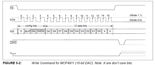

I've got a SPI slave device connected to my Laird BL652 (based on the nRF52832). The slave requires the following transaction on the SPI bus:
Note that the total transaction size is 16 bits.

I would have hoped many of operation bits are set by default but I guess not. So I have the following questions:
  • Given the SPI transaction as I showed it at the top of this question, what should be the values of the various operation bits.
  • Is there a C bit-field data structure (as I created in the code fragment below) to make it easier to manage the fields?
