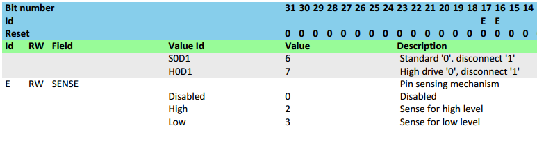

maybe the document of GPIO Pin sensing mechanism has some wrong.
maybe the document of GPIO Pin sensing mechanism has some wrong in the nRF51 Series Reference Manual (version 1.1).
sense high/low level defined in the document is different from the code of SDK 9.0.0.
high level is 1, low is 2;
PIN_CNF[n] (n=0..31): E RW SENSE Pin sensing mechanism DISABLED 0 Disabled HIGH 1 Sense for high level LOW 2 Sense for low level
code of sdk 9.0.0: high level is 2, low is 1;
  • @enum nrf_gpio_pin_sense_t
  • @brief Enumerator used for selecting the pin to sense high or low level on the pin input. */
typedef enum {
NRF_GPIO_PIN_NOSENSE = GPIO_PIN_CNF_SENSE_Disabled, ///< Pin sense level disabled.
NRF_GPIO_PIN_SENSE_LOW  = GPIO_PIN_CNF_SENSE_Low,                   ///<  Pin sense low level.
NRF_GPIO_PIN_SENSE_HIGH = GPIO_PIN_CNF_SENSE_High,                  ///<  Pin sense high level.
} nrf_gpio_pin_sense_t;
