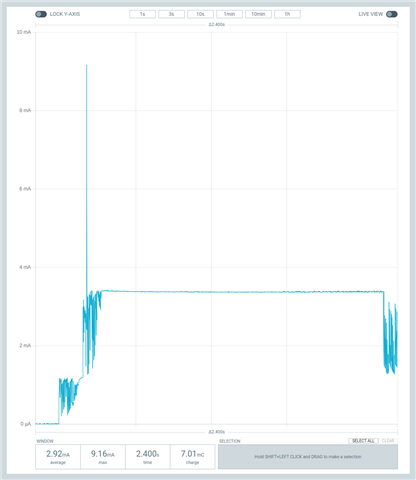

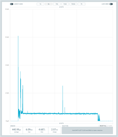

Problem facing here - flash is not properly detecting all the time. on every soft reset or pin to reset . QSPI flash is not ready but when i powered off and put back ON after some time the QSPI ready and reading the data.

when flash not detect the power goes to 2mA
