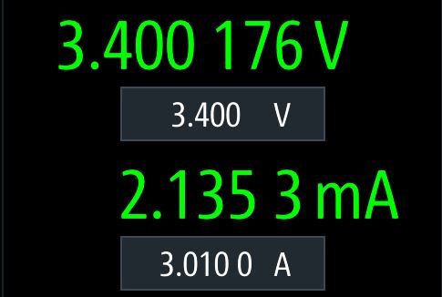

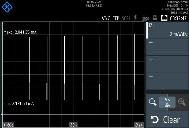

    I tried with the logic explained above, but the current consumption is more than what is expected.
    I have attached the readings for the same
    The current consumption is reaching 2.1 mA.
    Please during this bench mark i have disabled the UART logging.
    Ideally the system on sleep should consume current in micro amps right?

    Hard to tell from your plots, but is the minimum current consumption 2.131mA and maximum 12.041mA? If current consumption goes up to 12 mA, this means that the radio is active transmitting/receiving packets.

    Yes, during idle mode the current consumption is 2.13mA and during BLE transmission it reaches 12 mA.

  • I see that you are using the SAADC driver in your project.
    This will draw high current if it is enabled all the time.
    There is a low power option to only start the SAADC peripheral right before sampling, that you can enable in your sdk_config.h file:
    // <q> SAADC_CONFIG_LP_MODE  - Enabling low power mode
    #ifndef SAADC_CONFIG_LP_MODE
    #define SAADC_CONFIG_LP_MODE 1
    For this to work properly, you need to set the SAMPLES_IN_BUFFER define to the number of enabled SAADC channels (seems to be 1 in the project your attached).
