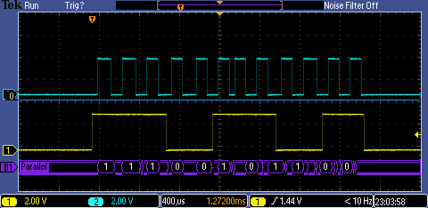

I'm using an external chip that decodes my RF transmission and outputs the data on two pins DAT, and CLK (data and clock). Currently I'm reading the data with GPIOTE, and was thinking about using SPI to collect the output.
SPI Slave uses CS pin to control the data gathering, so is there any method to "emulate" the chip select pin without need of physical pin connected ? I'm trying to lower the current consumption as much as possible and just need to catch several milliseconds of transmission.
