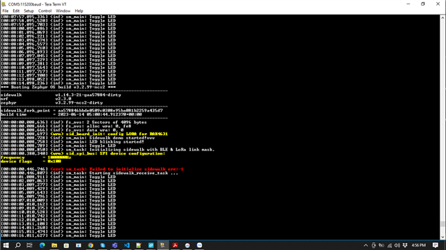

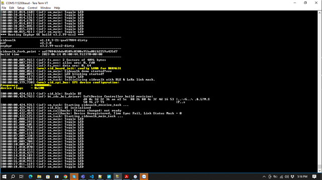

1/ Yes, we know, and this screenshot is the good one, we attached above just for reference/comparing with the bad one
2/ Actually, it was 1 Mhz, that time I changed the spi clock for testing, if spi clock is same as in document (8 Mhz), it doesnot work either.

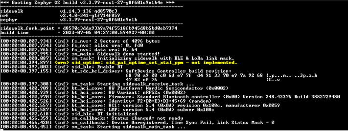

Dear Ahaug,
After updating the NCS (2.4.0) and Sidewalk SDK, the issue is gone. Thanks alot!
See screenshot.
