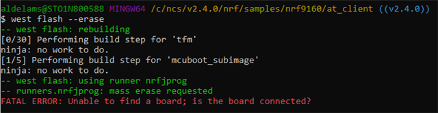

Building nRF9160 at_client fails due to "Unable to find a board; is the board connected?" in Bash through Toolchain manger
Using Bash from Toolchain manager. After I run "west flash --erase" I get FATAL ERROR: Unable to find a board; is the board connected?.
I have followed the instructions in https://developer.nordicsemi.com/nRF_Connect_SDK/doc/latest/nrf/config_and_build/programming.html#gs-programming-cmd and are trying to program the board. I have already upgraded the firmware with the programmer application with MCUboot enabled. Now i am connecting the Thingy:91 to my computer using the USB and trying to program it from bash. What am I doing wrong? because the nrfproj --com comes back empty!
Regards
Sarah
