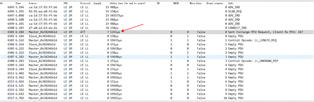

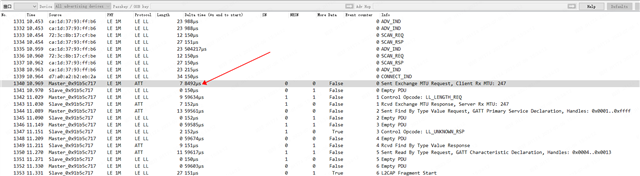

Hello, everyone
I used NRF52832 as the center and tried to connect to a peripheral, but after connecting for a fixed period of time, the center would actively disconnect from the peripheral. This problem is inevitable. This seems to be the result of an abnormal connector? And unfortunately, I couldn't fix the problem by modifying the peripheral configuration, only by modifying the center code.
The central application code is very simple, just a serial port passthrough service, and handles AT instructions from the serial port.
I provided the sniffer's log file, the center's main code file, and the Soc's log file.
Thank you

<debug> nrf_ble_gatt: Requesting to update ATT MTU to 247 bytes on connection 0x0.
<debug> nrf_ble_gatt: Updating data length to 251 on connection 0x0.
<info> app: Connecting to target B6FF93371DCA
<debug> nrf_ble_gq: Purging request queue with id: 0
<debug> nrf_ble_gq: Registering connection handle: 0x0000
<debug> ble_db_disc: Starting discovery of service with UUID 0xAE30 on connection handle 0x0.
<debug> nrf_ble_gq: Adding item to the request queue
<debug> nrf_ble_gq: GATTC Primary Services Discovery Request
<debug> nrf_ble_gq: SD is currently busy. The GATT request procedure will be attempted                       again later.
<debug> nrf_ble_gq: Processing the request queue...
<debug> nrf_ble_gq: GATTC Primary Service Discovery Request
<debug> nrf_ble_gatt: Data length updated to 27 on connection 0x0.
<debug> nrf_ble_gatt: max_rx_octets: 27
<debug> nrf_ble_gatt: max_tx_octets: 27
<debug> nrf_ble_gatt: max_rx_time: 328
<debug> nrf_ble_gatt: max_tx_time: 328
<error> nrf_ble_gq: SD GATT procedure (2) failed on connection handle 0 with error: 0x0000000D.
<debug> app: GATT Client Timeout.
<info> app: Disconnected.
<info> app: Disconnected. conn_handle: 0x0, reason: 0x16

    You are getting a ATT timeout, which we see both from the log and the error code (0xD = NRF_ERROR_TIMEOUT). This makes the nRF disconnect, which is why the disconnect reason is 0x16 = BLE_HCI_LOCAL_HOST_TERMINATED_CONNECTION.
    The sniffer trace shows a connection, then a LL_LENGTH_REQ from the central which gets a LL_UNKNOWN_RSP back, and then just empty packets with a high number of retransmits (odd but not directly related to the disconnect due to ATT timeout). The interesting part here though is the MTU request sent in #48, which is the only ATT transaction in the sniffer trace. The response never comes, and then the disconnect come sin #582, about 30 seconds after the MTU request, which matches the ATT timeout of 30 seconds. So the central disconnects because the peripheral does not respond.
    So everything here points to the issue being in the peripheral. If you are making that, then I would fix the issue in the peripheral. If not, then perhaps you can work around it by sending the MTU request, which you do by not configuring a higher ATT MTU. (Essentially remove the code in your main.c that initiates a MTU exchange and also ensure you don't have any SDK modules that do it, for instance by making sure NRF_BLE_GATT_MTU_EXCHANGE_INITIATION_ENABLED is set to 0 in your sdk_config.h).

    Afterwards, I made a similar attempt: setting up NRF_ BLE_ GATT_ MTU_ EXCHANGE_ INITIATION_ If ENABLED is 0, it will still disconnect (NRF-ERROR_TIMEOUT).
    After the connection was completed, the center immediately did two things: exchanging MTUs and enabling discovery services. After canceling the MTU exchange operation, the center first performed a discovery service after the connection was completed, but the peripheral still did not respond to the center's request. Similarly, due to no response, the center timed out and terminated the connection after a period of time.
    I have come to the conclusion that the first request made by the center immediately after the connection is completed will inevitably not receive a response from the periphery.
    Additionally, I found an interesting phenomenon: you can see from my code that the center can connect up to two peripherals. Amazingly, when this abnormal peripheral is connected as a second device, the peripheral will respond to the first request initiated by the center (MTU exchange or discovery service). When connected as the first device, it will not respond to the host's request. This phenomenon really confuses me.
    After multiple tests and observing the sniffer logs, I found that the host sends the same request packet but does not receive a response from the slave, and the DeltaTime is always less than the other one.
    Why is there such a difference when the second device of the same peripheral as the host is connected?

    DW2AT-R-first.pcapng:            Sniffer log, peripheral connected as the first device by the center.
    DW2AT-R-second.pcapng:     Sniffer log, peripheral connected as the second device by the center.
    First_ Connection_ No_ Respond.png:    a screenshot of the file DW2AT-R-first.pcapng
    Second_ Connection_ Respond.png:       a screenshot of the file DW2AT-R-second.pcapng
    DW2AT-R-first.pcapngDW2AT-R-second.pcapng
  • I think this issue can already be focused on two points:
    >When the peripheral is connected to the center as the first device, there is no response to the first request sent by the center after completing the connection. Is this a peripheral issue or a center issue? (For example, because the DeltaTime time is too short, the peripheral cannot process it in a timely manner)
    >When the peripheral is connected to the center as the second device, why is the value difference of DeltaTime so large for the first request issued by the center after completing the connection?

  • Hi
    Due to the summer vacation period we are currently understaffed, so delayed replies must be expected. I am sorry about any inconvenience this might cause. Einar is now out of office, so I will look into this case while he's away.
    As Einar said in his last reply, this seems to be an issue on the peripheral side, where it doesn't seem able to complete an MTU exchange. Are you able to debug to see if there are any error codes indicating what exactly goes wrong within the MTU exchange?
    1. The reason for this disconnect could be because the peripheral tries to call an MTU request when it connects, but the central starts scanning for a new device instead, which could trig a timeout like this.
    2. This is likely because the central has to maintain the connection to the first connected peripheral, so it needs some extra time to connect to the next peripheral.

  • Hi
    After these days of debugging, the main reason is that the peripheral inability to respond to any requests that are immediately initiated by the connection. So I made changes to the completion of the connection:
    >The mtu exchange request cancel (NRF_BLE_GATT_MTU_EXCHANGE_INITIATION_ENABLED set to 0)
    >The discovery service opens after the connection is completed two seconds later.
    Finally can you provide a sample code?? actively initiate the mtu exchange request in the center application.
    I want to actively send mtu exchange requests in the place and time I want in the central application code, but I haven't found the relevant sample code
