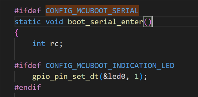

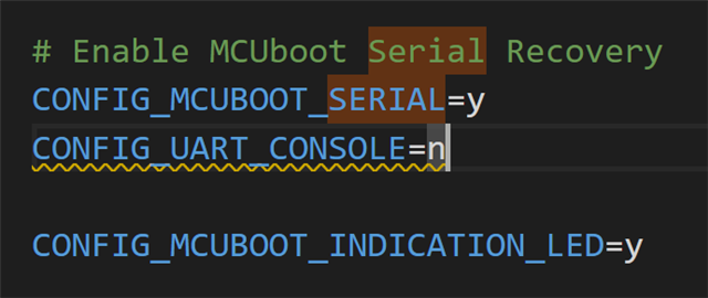

  •  Thank you for the suggestion.
    I think the option of using Serial recovery would be good one.
    Please can you explain a bit on how to use serial recovery and what needs to be changed in the current smp_svr application.
    Thank you!
  • I have explained this in my my unofficial tutorial on MCUboot, where you also can find examples for Serial Recovery
