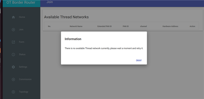

After running the docker I formed thread network using OTBR-web page, and then I entered into docker using following command "docker exec -it otbr sh". After entering into the docker I started thread interface using following commands
ot-ctl ifconfig up
ot-ctl thread start
After this I can see the state of OTBR  as leader.
But when I opens the otbr-web and click on Join, I'm getting following error
And when I'm running the chip-tool using following command
./chip-tool pairing code-thread 0x5671 hex:<Operational dataset> payload --bypass-attestation-verifier true
I'm getting following error in chip-tool :
