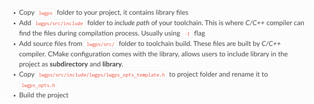

  • The image below is what I found in the LWGPS documentation i.e, there are the modules that I want to include.
    add them to the build system using the target_sources macro like how it's done with main.c

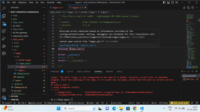

    P.S: I pasted the .c and .h files in the CMakesLists.txt as
    target_sources(app PRIVATE src/lwgps.c)
    target_sources(app PRIVATE src/lwgps_opts.h)
    These are present in the source directory of project as you suggested and I tried accessing them from main.c as
    #include <lwgps_opts.h>
    I am also attaching the whole file for reference.hello_world_nordic.zip

    Edit : I tried understanding the structure of the 3rd party library : lwgps\src\include has lwgps.h(contains #include "lwgps/lwgps_opt.h" ) and lwgps_opts_template.h (this is the file they asked me to change to lwgps_opts.h and import to my project).
    Add lwgps/src/include folder to include path of your toolchain. This is where C/C++ compiler can find the files during compilation process. Usually using -I flag
    Add source files from lwgps/src/ folder to toolchain build. These files are built by C/C++ compiler. CMake configuration comes with the library, allows users to include library in the project as subdirectory and library.
    I don't understand how to do the above things for NRF as this is simply not a .h and .c file and is interleaved.
    So this is an issue that I don't understand how to solve it.
