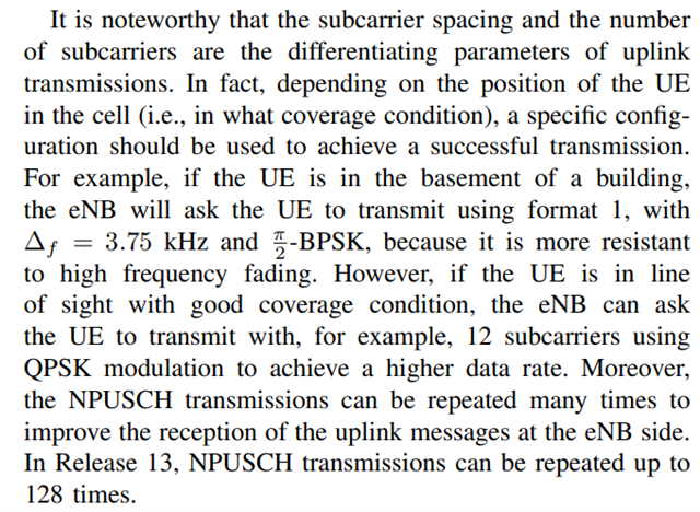

    Subcarrier spacing is determined by the network. Current consumption differs as the uplink transmission time and available data rate depend on subcarrier configuration. Here are a couple of helpful links/references:

    In the UL, Single Carrier Frequency Division Multiple Access (SC-FDMA) is applied, either with a 3.75 kHz or 15 kHz subcarrier spacing. eNB decides which one to use

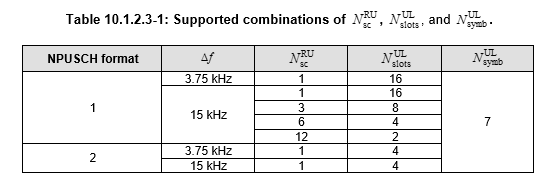

    For Narrowband Internet of Things (NB-IoT) operation, a UE operates […] in the uplink using a single sub-carrier with a sub-carrier bandwidth of either 3.75kHz or 15kHz or alternatively 3, 6 or 12 sub-carriers with a sub-carrier bandwidth of 15kHz.
    3GPP TS 36.211 V13.13.0 (2019-12)
    10.1.2.3 Resource unit
    3GPP TS 36.213 V13.16.0 (2020-03)
    16.5.1.1 Resource allocation
    The subcarrier spacing [Delta-f] of NPUSCH transmission is determined by the uplink subcarrier spacing field in the Narrowband Random Access Response Grant according to subclause 16.3.3.
