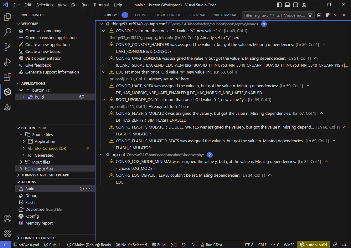

We have installed NRF Connect SDK / Toolchain through the Connect App. We then open up VSC and "Open an existing application", choose from "C:\ncs\v2.4.0\zephyr\samples\basic\button" and let it compile.
When right click and select "Go to definition" on sw0 on line 20 of main.c, it just returns "No definition found for 'sw0'".
We tried Ctrl+Shift+P - "nRF Connect: Add nRF Connect SDK to Workspace" - to no avail.
We tried File -> Add Folder to Workspace on our NCS folder - to no avail.
So, what's up? How to get the "Go to definition" to work in VSC using nRF Connect?

    I have build it (first pristine, then normal build). Does not work. Also, I have made sure that 2.4.0 toolchain is installed and is what is used.
    What I select after opening existing application in the build configuration:
    Then I do a pristine build, after which is complains that the CMAKE extension is not the correct one (I just did a complete fresh install on a brand new computer, which is the fourth computer on which I can reproduce this exact issue!).
    So I disable that extension, now NRF connect VSC thing is happy... I then save the workspace and do a normal compile (click the Build button), and I get the following warnings:
    And the go to definition for the sw0 is still not working.
    Now, it seems to me it has to do with linking the devicetree with the C file(s)?

    Normally you can go to definition for variables, but those devicetree aliases (DT_ALIAS(..)) might be the exception. You will need to open the .dts file for the board you are working with, in my case nrf52840dk_nrf52840.dts.
    Kenneth
