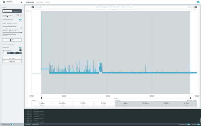

2. Then we've got Fanstel EVM-BT40 kit and we've measured there 1.44mA. A current consumption profile attached. So far, so good!

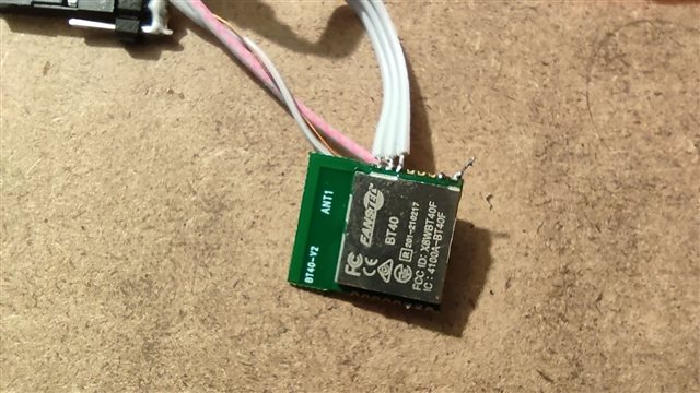

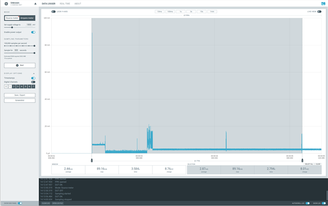

3. Then we've got a standalone Fanstel BT40 module only and connect to it just minimal wiring - only put it power supply of 1.8V on VDD pad and short-circuit VDDH to VDD as per Nordic recommendations. With 100% absolutely the same code flashed on it we've measured 2.87mA average power consumption which is almost twice than required! Disappointed

As you can see on the diagrams, in the case of Fanstel EVM-BT40 kit there is more noise during boot, but the consumption between BLE Tx packets is lower.
In the case of standalone BT40 module, during boot-up there is less noise, but the consumption is a way higher between the BLE Tx packets.

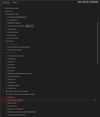

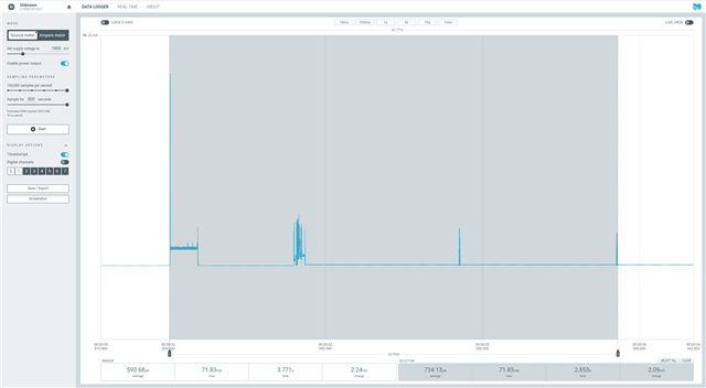

    I saw in the Kconfig there is an option called "Device Drivers -> Flash Hardware Support" (probably forgot to strip this down while was removing UART/console functionalities). Just removed the tick, rebuild the code, flashed the standalone Fanstel BT40 module and voila - I see consumption of 734 microamps, which is awesome!!!
    Would be glad to read an explanation why removing it gives so much power gain having in mind I don't have any QSPI/Flash interactions in my code...
