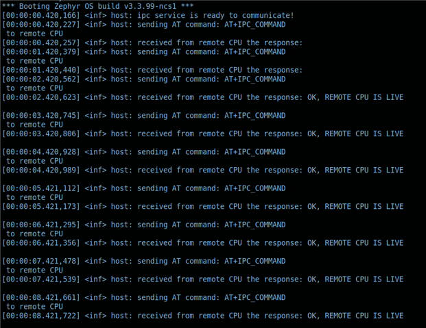

RPMsg in thingy53 with Segger J-Link mini Edu Not showing the messages in the console
I stay trying this project github.com/.../rpmsg_playground
based on this video: www.youtube.com/watch
(openAMP/RPMsg in nordic thingy:53(nrf5340 dk)
Everything compiles and flashes OK, but the RPMsg messages from the Cores don't come out in the Console. I've used JLinkExe, JLinkExe -if SWD
(Both with h and g option combined after connect and speed) and also combined with JLinkRTTClient opened in another terminal
I stay using JLINK MINI EDU By SEGGER
Notes:
1) i stay using zephyr 3.3 and NCS
2) In github link I have several photos (like the one below) that demonstrate my issue:
https://github.com/neuberfran/rpmsg_playground/blob/main/photo04.png
3) I already did a blink led on this board now (using Zephyr 3.3) and it worked. Then I used the command: nrfjprog --eraseall to clean up.
How to solve?

    As the video above, I was successful but not the way I would like. I had to change the original project code and I don't know why. I had to comment out the line k_sem_take(&bound_sem, K_FOREVER); (in two places) in cpuappNet's main.c code:
    https://gist.github.com/neuberfran/482feff176d5b28cb8710497bf20cd97
    I want to know if there is a way to work, keeping the k_sem_take(&bound_sem, K_FOREVER);???

  • "My understanding is that you've had issues getting the log from the netcore of a 53?"
    Thanks for taking this case. In reality, it is now more in-depth learning of traffic lights. Really, I haven't had good logs on this project. I don't know if due to misuse (or use in this case) of USB_CDC. I'm using RTT just like the original video. But (logs) shouldn't be a problem,
    because I invested in a SEGGER Edu Mini.
    "Did you copy the project made in the video, or did you just try to follow along on some steps mentioned in it? If so, could it be that you've skipped a step?"
    1) Yes
    2) More or less. The file below is the only one that raised a doubt
    https://github.com/neuberfran/rpmsg_playground/blob/main/aci/CMakeLists.txt
    https://postimg.cc/Xr0ttqjZ
    As you can see in the image above, if I change line 4 (for example) to: SOURCE_DIR ${CMAKE_CURRENT_LIST_DIR}/..../cpunet I don't get any errors. this is intriguing
    Finally, I would like you to prove to me that I only need to comment this line now, because my project is newer than the one in the video and in the video the author used an older version of ncs and zephyr
    If that's the case, of course, there's no problem and there's nothing you can do about it.
    The project is on my github if you stay trying do in your 53
    Tks
