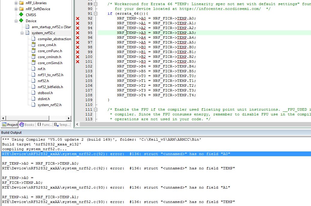

Are there A0 field in NRF_TEMP_Type?
I can not compile the example project 'ble_app_uart_s132_pca10036' ,in nRF52_SDK_0.9.2_dbc28c9\examples\ble_peripheral\ble_app_uart\pca10036\s132\arm5_no_packs.the error given by mdk 5.15 is 'RTE\Device\nRF52832_xxAA\system_nrf52.c(92): error: #136: struct "" has no field "A0"'keil.png
  • Hi, you are using older version of soft device .i.e 8.0.3. If you are using Keil, then upgrade it to 8.2v. That devicePack contains the fix of ERRATA #66. I tried and got rid off but stuck somewere else tough. So Thats the fix for you! There is no readymade Project Template to get started with LATEST Device PACK plus latest alpha release of S312. hence one have to struggle for now with latest Dev kit of NRF52832.
