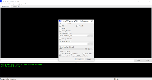

  • Thanks for you suggesting ipc_service sample. I can build and flash image but I can't see any log messages of NET core.
    Procedure to reproduce this issue is as follows.
    1. cd D:\ncs\v2.3.0\nrf\samples\ipc\ipc_service
    2. west build -b nrf5340dk_nrf5340_cpuapp
    3. west flash
    4. Lauching RTT Viwer and slecting NRF5340_XXAA_NET target device

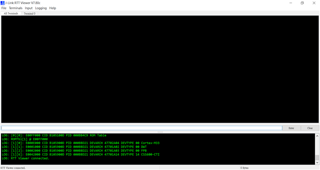

    5. RTT Viwer shows "LOG: RTT Viewer connected" but doesn't show any log messages.
  • I don't have a nRF5340 hardware to test at the moment. Do you know if both cores were flashed when you run west flash? If you are not able to tell, please give me the log of west flash.
  • Thanks for your reply! I try to find command for generating west flag log file. But I can’t find command from docs.zephyrproject.org/.../build-flash-debug.html
  • You just need to show me what the command line prints out immediately after west flash.
    Please also check which log backend the network core is logging to. See in <network core child image build folder>/zephyr/.conf file, and search for all the CONFIG.*LOG_BACKEND configurations.

  • Hi Snowuyl,
    Hieu is on holiday now and this case has been transferred to me. From your many other cases I can see that you have gotten RTT working.
    However, after trying to actually run the IPC_service sample on NCS v2.3.0, I should copy here what I told you in another case (in case other DevZone users read this):
    It turns out that the IPC service sample (and some others, I suspect), are completely broken on NCS 2.3.0.
    I believe that earlier NCS versions worked, and I can confirm that NCS v2.4.0 works as well. Are you early enough in development that you could upgrade your NCS version to v2.4.0? I would strongly recommend it.
    Raoul
