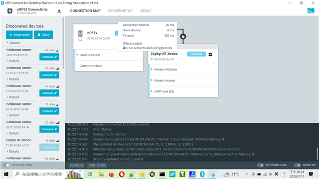

Thanks for your reply! Does Nordic provide sample code for AES encrypting the pairing and bonding?
Encryption is done automatically by the BLE stack when a connection is in paring or bonding, so you don't need to worry about code.
