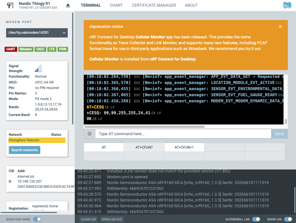

As I run the LTE Link Monitor (v.2.0.4), I can see the thingy91 can be correctly accessed.
 LTE Link Monitor

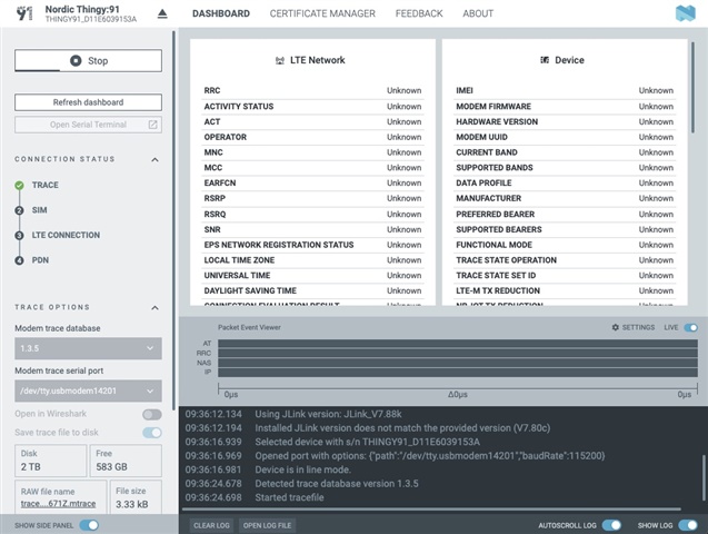

Since this App is marked as deprecated, I switched to Cellular Monitor, but it will keep running on the following screen.
Not sure what I miss, please advice.

    I tried the re-program and re-boot the Thingy91 and realize that a reboot of Thingy91 after running the LTE Link Monitor would fix the issue of Cellular Monitor I mentioned above.
    I am new to Thingy91 and still in the very early stage of evaluation, so I am not aware which would cause the issue, but, anyway, it works okay now.
