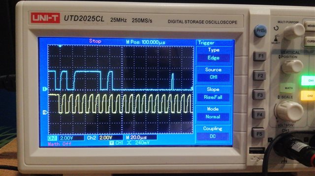

I am using nrf52833DK, NCS version 2.3.0, and VSCODE studio as an IDE. I am integrating the tlv493D sensor with nrf52833.
The issue I am facing is that
I have two sets of sensors available , address of both are 0x5E
1)shield2go  tlv493D
2)adafruit   tlv493D
My code is working fine with only

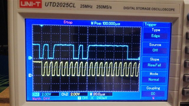

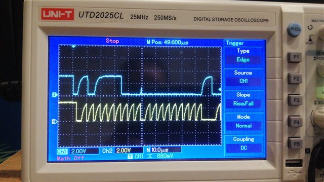

  1)shield2go  tlv493D. but when I interface
  2)adafruit   tlv493D .NOT WORKING. I used Oscilscope the sensor is not sending ack against the address.
Both sensors pins are pulled up by 3v
* I wrote the same code in Arduino ide for esp32 and it's working for both sensors.
  1. can anybody tell me how to set the i2c pins as an open drain? because this is the only option left.
  2. If you go through the 3 oscilloscope images then the 8th bit is high (for read ) from esp32 but low from nrf52833 (should be high for read but still reading )
  3. is it any option to send 8th bit as high (read)

esp32 communication with adafruit tlv493d sensor
esp32 communication with shield2go tlv493d sensor
nrf52833 communication with shiled2go tlv493d sensor
