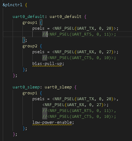

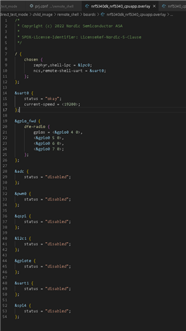

I opened the direct_test_mode sample from Toolchain version 2.3.0 and built with the default settings (nrf5340dk_nrf5340_cpunet as the board and "Use build system default"). Then I flashed the firmware on the 5340DK and the - Direct Test Mode app on Windows 10 can select the device, but not communicate with it. I've attached the log and a screenshot here of the flashing commands.
If I edit the build configuration to prj.conf then I get the error below:

  • Hi Brad
    In the project you uploaded, it seems like UART0 is still set to use pins P0.17 and P0.18, and the visualizer indicates that as well.
    uart0_default: uart0_default {
                phandle = < 0x8 >;
                group1 {
                    psels = < 0x1c >;
                group2 {
                    psels = < 0x1001b >;
                    bias-pull-up;

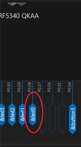

    Additionally, the visualizer shows that P0.28 is configured to LED0 on our end, which would explain why P0.28 and P0.27 won't work as UART pins if you also have a LED configured on one of the pins
    Simon
