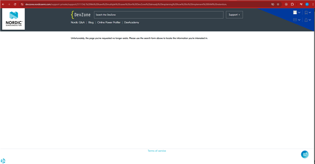

  •  the link you provided does not work anymore. Can you please give new link?
