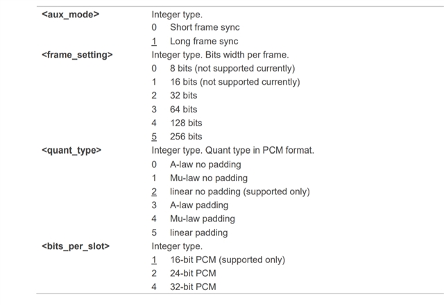

We need to stream audio from nRF5340 to LTE module. But our LTE module support PCM format audio.
I checked that nRF5340 support mono audio streaming through I2S. Is it possible to interconnect them.
Attached our module PCM format. Please let us know can we interconnect both?
Thanks
