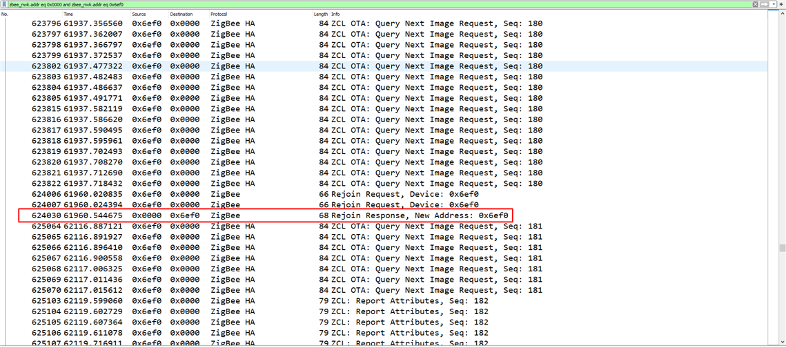

I'm developing a battery-powered Zigbee Sleepy End Device, and I have a randomly "loose network connection" issue with my device. By randomly I mean that the same device can work for 2 weeks in the test and in the next test with the "same" testing environment it will lose network in one day. And by "loose network connection" I mean that device messages can be seen by ZC but commands from ZC to ED are sent but not received. ZC still think that ED is in the network and ED thinks that it is in the same network but something in their communication is wrong.

After 17 hours I checked all device if they are still working and one of them was not. In the Home Assistant I check reporting from the device(when device sends attribute change) and sending command from HA to the device(when HA sends attribute change to the device), reporting was okish(HA receives about 50% of them) but command send is failed (HA sended 30 commands and device didn't responded once).
In HA device still in the network and after I connected device to the SEGGER with debugger I saw that ZB_JOINED is true and network PAN is correct.

In the logs file three devices addresses are:
- My device battery powered - 0x6EF0 - this device has "lost network connection"

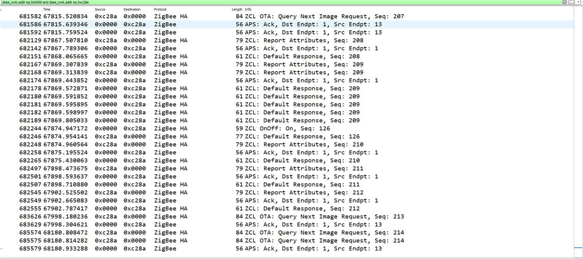

- My second device battery powered - 0xC28A

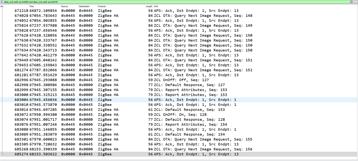

- Nordic dev board - 0x0445

Nordic dev board 0x0445 communicated to HA and received messages from it until I stopped the logs.
Second device 0xC28A communicated to HA and received messages from it until I stopped the logs.
And First device 0x6EF0 (that lost network connection) stoped responding to HA messages after network rejoin.
HA still think that first device(0x6EF0) is in the network and sends find route request.
The first device still send attribute reporting and OTA request to HA.
They are both in the same network have same Network security Key but don't hear each other.
I can't understand what causes this issue and I need to know where to search next.

  • Forgot to mention if I turned off the first device(removed the battery and put it back in after 5 seconds) the unit booted up fine and automatically connected to the network and is now fully functional.

    Jørgen is out of office, so I have taken over your ticket.
    One thing I see in the sniffer log is that the device sends a Device Announcement that is not acknowledged. There is a known issue related to this, where the end device does not recover from a broken rejoin procedure.
    Can you try the workaround for the known issue and see if that makes the end device able to successfully rejoin the network?
