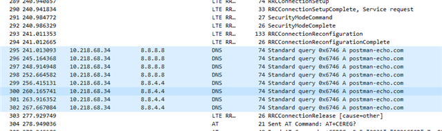

Hello, I am having an issue where I can only connect over HTTP in the first minute or so after running AT+CFUN=1. After this the requests time's out with ERROR.  Toggling the modem via AT+CFUN=0 AT+CFUN=1 will again create a short time window when the HTTP connection is successful.
I am currently using the nRF9160 DK with modem firmware 1.3.5 and the Serial LTE Modem application.
Attached is the set of AT commands which reproduce the issue and modem trace while reproducing the issue.
Any ideas as to what might be causing this?

    can you do a modem trace of a successful HTTP connection? From the log it seems that all of the connection attempts are failing.
    Attached is a new trace where the first HTTP connection is successful. To make sure of this, I performed a GET request which returned some data. The trace was produced with the AT commands included below. Please let me know if this helps.

  • This seems to be the problem
    The DNS queries are timing out it seems. I would recommend you to investigate why the DNS is not responding after the first time.
    I do not have much experience with DNS, would you be able to recommend how to investigate this?
  • Have you tried changing to different DNS servers, to see if the behavior is the same?
