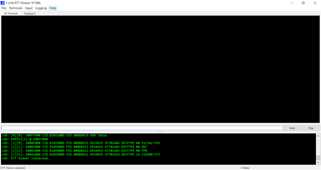

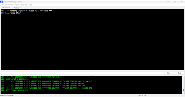

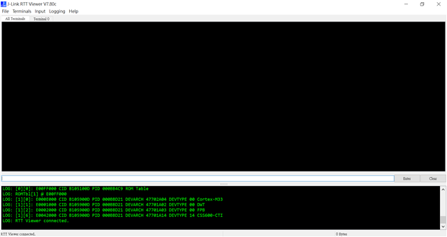

RTT Viewer doesn't show any debug messages of hci_rpmsg from nRF5340 NET core
Procedure to reproduce this issue.
1. cd D:\ncs\v2.3.0\zephyr\samples\bluetooth\hci_rpmsg
2. west build -b nrf5340dk_nrf5340_cpunet
3. west flash

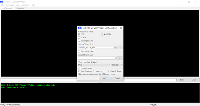

4. Lauching RTT Viewer and selecting NRF5340_XXAA_NET target device
5. RTT Viewer doesn't show any debug messages
The following are log messages of RTT Viewer. Why does it shows "Security extension: not implemented"?

LOG: RTT Viewer connected.

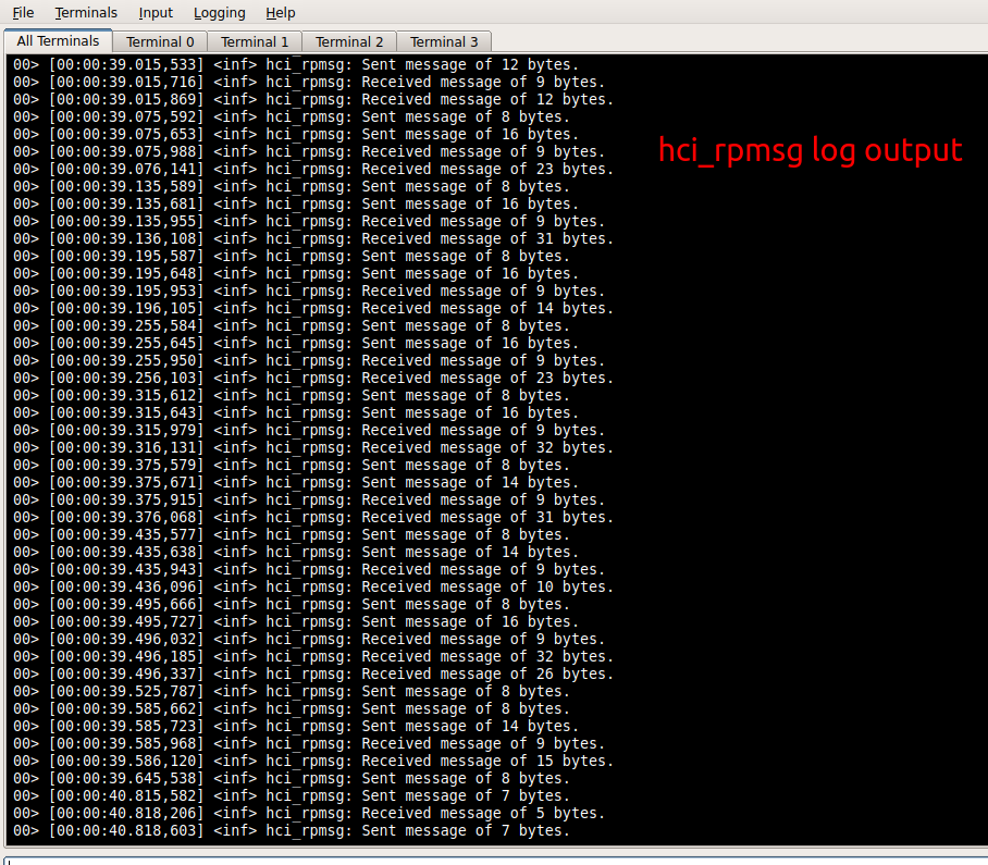

    Have you enabled the logger module and RTT backend? It is not enabled by default in the hci_rpmsg sample.
    https://developer.nordicsemi.com/nRF_Connect_SDK/doc/2.4.0/nrf/app_dev/logging/index.html#logging-in-ncs
    Vidar

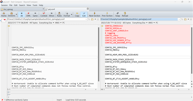

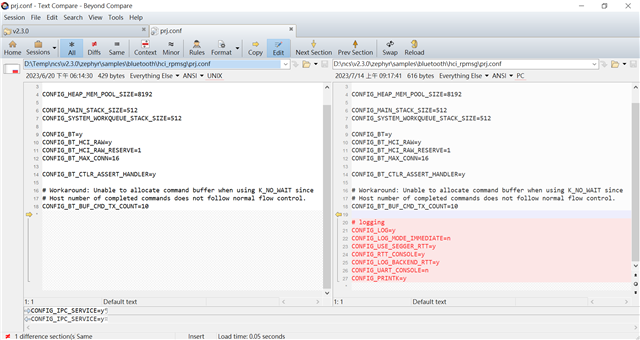

  • I have added the following configuration in prj.conf file. But I still can't see any debug messages shown on RTT Viewer.
    # logging
    CONFIG_LOG=y
    CONFIG_LOG_MODE_IMMEDIATE=n
    CONFIG_USE_SEGGER_RTT=y
    CONFIG_RTT_CONSOLE=y
    CONFIG_LOG_BACKEND_RTT=y
    CONFIG_UART_CONSOLE=n
    CONFIG_PRINTK=y

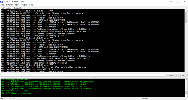

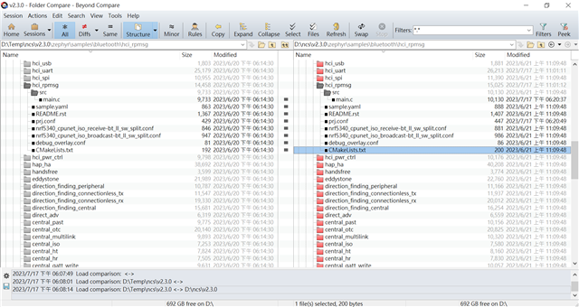

  • I have reverted main.c and prj.conf. But bus fault still occurred. 6521.hci_rpmsg.zip is zip file of hci_rpmsg folder I use. And west_forall_git_status_2.txt is result of west forall -c "git status" command after reverted main.c and prj.conf. Which version of Ncs do you use?
    00> *** Booting Zephyr OS build v3.2.99-ncs2 ***
    00> [00:00:00.001,647] <inf> bt_sdc_hci_driver: SoftDevice Controller build revision:
    00> d8 0c 2d 2f 36 ae e2 5c 80 26 80 4c 3f 4d 16 53 |..-/6..\ .&.L?M.S
    00> 50 96 c7 73 |P..s
    00> [00:00:00.002,563] <inf> bt_hci_raw: Bluetooth enabled in RAW mode
    00> [00:00:00.002,807] <err> os: ***** BUS FAULT *****
    00> [00:00:00.002,838] <err> os: Precise data bus error
    00> [00:00:00.002,838] <err> os: BFAR Address: 0x20070000
    00> [00:00:00.002,868] <err> os: r0/a1: 0x210026c0 r1/a2: 0x00000001 r2/a3: 0x00000001
    00> [00:00:00.002,868] <err> os: r3/a4: 0x20070000 r12/ip: 0x01025db5 r14/lr: 0x0102a4e5
    00> [00:00:00.002,899] <err> os: xpsr: 0x69000000
    00> [00:00:00.002,899] <err> os: Faulting instruction address (r15/pc): 0x0102d358
    00> [00:00:00.002,929] <err> os: >>> ZEPHYR FATAL ERROR 0: CPU exception on CPU 0
    00> [00:00:00.002,990] <err> os: Current thread: 0x21008000 (unknown)
    00> [00:00:00.805,267] <err> fatal_error: Resetting system
  • D:\ncs>west forall -c "git status"
    === running "git status" in manifest (nrf):
    Not currently on any branch.
    Changes not staged for commit:
      (use "git add <file>..." to update what will be committed)
      (use "git restore <file>..." to discard changes in working directory)
            modified:   samples/crypto/aes_cbc/prj.conf
            modified:   samples/crypto/aes_cbc/src/main.c
            modified:   samples/ipc/ipc_service/prj.conf
            modified:   samples/ipc/ipc_service/prj_icmsg.conf
            modified:   samples/ipc/ipc_service/src/main.c
            modified:   samples/nrf5340/multicore/prj.conf
            modified:   samples/nrf5340/multicore/src/main.c
            modified:   samples/nrf5340/multiprotocol_rpmsg/prj.conf
            modified:   samples/nrf5340/multiprotocol_rpmsg/src/main.c
            modified:   samples/peripheral/radio_test/child_image/remote_shell/prj.conf
            modified:   samples/peripheral/radio_test/conf/remote_shell/prj_usb.conf
            modified:   samples/peripheral/radio_test/prj.conf
    Untracked files:
      (use "git add <file>..." to include in what will be committed)
            boards/arm/am_nrf52832/
            boards/arm/custom_nrf52832/
            boards/arm/mdbt53db_nrf5340/
            samples/ble_dfu_peripheral_lbs/
            samples/mcuboot_smp_ble/
            samples/minimal_log/
            samples/minimal_log_afe4900/
            samples/minimal_log_afe4900_interrupt/
            samples/minimal_log_button_2gpioe_failed/
            samples/minimal_log_button_2gpioe_ok/
            samples/minimal_log_button_gpio/
            samples/minimal_log_button_gpioe/
            samples/minimal_log_button_led_power_adv/
            samples/minimal_log_button_led_power_adv_pairing/
            samples/minimal_log_cpu_idle/
            samples/minimal_log_flash/
            samples/minimal_log_flash_erase/
            samples/minimal_log_flash_jedec/
            samples/minimal_log_gpio/
            samples/minimal_log_i2c/
            samples/minimal_log_nus/
            samples/minimal_log_nvs/
            samples/minimal_log_rpmsg_service/
            samples/minimal_log_timer/
            samples/peripheral_lbs_rtt/
    no changes added to commit (use "git add" and/or "git commit -a")
    === running "git status" in zephyr (zephyr):
    HEAD detached at refs/heads/manifest-rev
            modified:   drivers/flash/spi_nor.c
            modified:   include/zephyr/drivers/flash.h

  • Thanks for your support! I can see printk() log messages from nRF5340 NET core after adding the following configuration to prj.conf.
    CONFIG_CONSOLE=n
    CONFIG_SERIAL=n
    # logging
    CONFIG_LOG=y
    CONFIG_LOG_PRINTK=y
