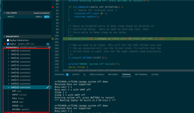

pm_state_force(0u, &(struct pm_state_info){PM_STATE_SOFT_OFF, 0, 0}); Causing reboot
I have a callback for button and instead of going to sleep it reboots?
void wakeButtonPressed(const struct device *dev, struct gpio_callback *cb, uint32_t pins)

		int gpio_pin = NRF_DT_GPIOS_TO_PSEL(DT_ALIAS(sw1), gpios);
		if (gpio_pin >= 0)
			nrf_gpio_cfg_input(gpio_pin, NRF_GPIO_PIN_PULLUP);
			nrf_gpio_cfg_sense_set(gpio_pin, NRF_GPIO_PIN_SENSE_LOW);
		k_sleep(K_MSEC(1000));
		state = SLEEP_STATE;
		k_sleep(K_SECONDS(2U));
		printk("ERROR: System off failed\n");

I used https://github.com/nrfconnect/sdk-zephyr/blob/main/samples/boards/nrf/system_off/src/main.c as an example
