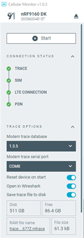

    Could you take a modem trace, so we can see if the problem is on the modem side?
    I've attached a version of the modem shell, built for the nRF9160 DK, with modem tracing enabled.
    Before you send the AT+CFUN=4 command, please send AT%XMODEMTRACE=1,2 to ensure that the modem has tracing enabled.
    mosh_mtrace.hex
    Didrik
  • I executed AT%XMODEMTRACE=1,2 and it returned OK and then I executed AT+CFUN=4. It stucked again and didn't produce any extra output for tracing.
    I also tried your mosh_mtrace.hex but it didn't work on my dev board. Instead of proper mosh outputs it put non-human readable characters to the screen like that:
