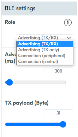

    Firstly, I have a few questions to ensure I understand the BLE correctly.
    1. What is advertising TX/RX ? I thought advertising is when the device only sending data to the outside world and not reading any data until a connection is established

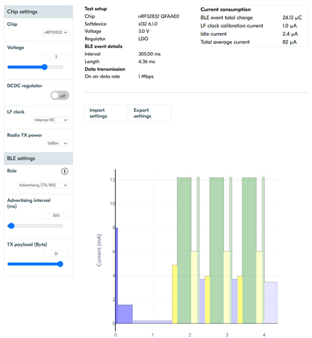

    2. Why if I set advertising interval to 300ms, the interval shown in the summary chart is 305ms ? It always 5ms more than my selected advertising interval

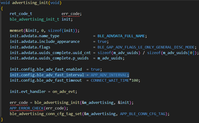

    3. If my macro APP_ADV_INTERVAL is 300, does it mean it set the advertising interval to 300ms. Or is it 300 multiply by a time factor?
    I realized my previous report from Online Power Profiler Tool was incorrect as I forgot to set the correct advertising interval. I should get around 100uA consumption when advertising BLE + SAADC. As I mentioned earlier, my board consumes 1mA. Sorry for my wrong terminology but when I used the world "timer", I mean RTC as the Low power SAADC example code uses RTC for trigger source. Other than BLE and SAADC, my board doesn't perform any other task during advertising, the programs just sits in an idle state during advertising. There is also no TIMER instance is used in the code at all. I have replaced all TIMER by APP_TIMER or RTC2. Therefore, I'm really confused why my current consumption is so high.
    RX must be enabled if you want to be able to receive connection or scan requests from surrounding scanners. Without RX, you can only to non-connectable advertising.
    The interval is given in units of 0.625 ms, so 300 corresponds to an interval of 187.5 ms.
    This depends on how you have configured the SAADC. The OPP estimates the system current based on BLE activity and does not cover SAADC usage. I suggest you measure the current in your application with only BLE enabled to verify if you can match the OPP numbers. You can also try the demo project I uploaded in the linked Q&A.
