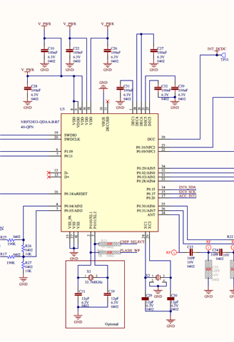

       I am currently facing an issue while working with the nRF52833 microcontroller, nRF Connect SDK, and Visual Studio Code. I have made modifications to the devicetree of the "nrf52833dk_nrf52833" to accommodate our custom board.
The problem I am encountering is related to the firmware development using the simple examples provided in the nRF Connect SDK, such as "blinky," "uart," and "gpio." While these examples work flawlessly in debug mode, I am facing difficulties when trying to flash the program onto the nRF52833. After flashing, the code does not execute as expected. Furthermore, when I attempt to operate in debug mode again, the following errors are generated:

FATAL ERROR: command exited with status 33: nrfjprog --program 'd:\NRF_Workspace\blinky_spi_test\build\zephyr\zephyr.hex' --sectoranduicrerase --verify -f NRF52 --snr 50128667
     To successfully operate the controller in debug mode, I have to erase the chip. After stopping debugging and resetting the microcontroller, the firmware runs as expected. However, when the power is turned off and then back on, the firmware does not work.(seems to corrupt the flash memory).
     However, this issue only arises when using the nRF Connect SDK with Visual Studio Code. Previously, when I was using Segger Embedded Studio and nRF5 SDK, the firmware worked perfectly fine without any issues.

    A: Unfortunately, I don't have an nrf52 development board, so I couldn't observe the behavior on any other board. However, I have tested the applications on multiple custom boards, and they all exhibited the same result.

    I could not reproduce your issue on nrf52833-dk using blinky application in NCS v2.4.0. I built the sample both with and without debug options enabled and flashed the firmware to the board without issues. I could also debug without problems. With stopped debugging, I restarted the board by power cycling off/on and everything seems to be working as expected.
    Since this firmware was previously working, I guess something might be wrong with your testing environment.
    Is it only the problem with flashing and debugging but building with NCS v2,4,0 and VS Code works as expected?
    Have you tried flashing with "west flash" instead of "nrfjprog --program"?
