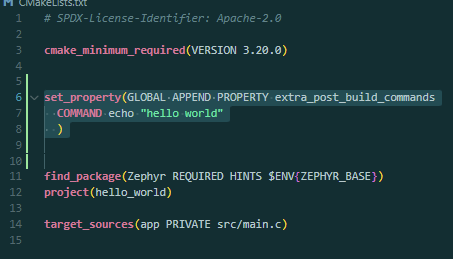

    In its simplest form, it looks like this:
    set_property(GLOBAL APPEND PROPERTY extra_post_build_commands
      COMMAND echo "hello world"
    Although as far as I understand, it's important that this gets placed before zephyr gets pulled in (with "find_package(Zephyr REQUIRED HINTS $ENV{ZEPHYR_BASE})"):

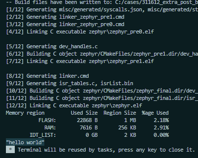

    When I add the above to the CMakeLists.txt of a freestanding hello world sample, it seems to work well:

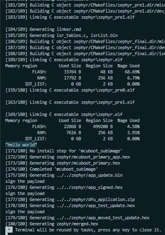

    When I add mcuboot (CONFIG_BOOTLOADER_MCUBOOT=y) to introduce a child image, I see that the "extra command" still gets executed after the compiling and linking steps:
    Although as you can see, there are now other steps occurring afterwards. I believe they are also executed through the extra_post_build_commands mechanism.
    Is this acceptable for you? Or do you need your command to be executed at the very last? In that case I will have to research what determines the ordering of the post build commands.

    Based on your example, the app_update.bin and app_signed.bin is also generated by a post build step and is generated after your hello_world.  This is probably happening because the application cmake appends at the beginning of the cmake file.
    Is there any way to append on to the extra_post_build steps after the find_package has added the steps for app_update.bin generation?
