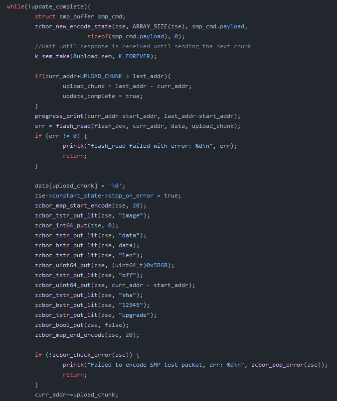

    I don't exactly need to know what the IPC service does and how it connects to the app core but that pipeline is what send the firmware from the netcore to the app core that handles reflashing. I am only interested on how to packet the firmware data and put it into the ipc service. I am using the SMP server sample with bluetooth overlay as guidance but that example is only viable of the client sending over the data has the packets already assembled in a way that the server understands them as "firmware upgrade". Lets say I have one nrf5340 running stock smp server example code with the bluetooth overlay, and for the other nrf5340 I want it to be acting as the client sending over the firmware. Hypothetical if I program the client with simple bluetooth code that is able to connect to the server nrf5340 with the stock sample code. I then on the client side send over VCOM (cpunet) the raw .bin file to the net core and being connected to the smp server via bluetooth I am sending raw binary packets. When the server receives those how will it now that these bluetooth packets are now for updating the firmware for the app core on the server side? This is what I am trying to understand on how to make these packets so the server can understand what I will send from the client nrf5340 to the server nrf5340.
    Thank you for the github repo on the bootloader samples in there I found sample of the "client_smp/smp_client_ble" repo showing off exactly what I am after, but it is based on the nrf52840 chipset. In the client codebase when sending the data over the packets are formed using zcbor functions:
    Now because the nrf52840 is a single core chip the radio functions are running on the same core as the smp server, my questions here is if there is another step of encoding/packetizing being done on the nrf5340 IPC as the data moves between cores and if the appcore needs to unpack what come from netcore and then sends the packet further along to the smp server, or is this all the magic behind it?
