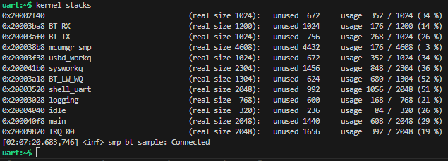

    I see, thank you for the references. With the smp_svr sample and included hci_rpmsg the hci_rpmsg opens up the IPC service like how it is described in the .dts file on the shared memory. From what I understand some task in the application core opens the same instance and they start communicating through that medium. The application task that communicates through IPC I assume is writing to flash. But the packets are formed in a certain way so that the task knows if that is for being written to flash or any other commands based on the packet. In the smp_svr main.c there isn't anything that shows opening any IPC service so I assume the task is initialized prior with the configs and runs in the back. When I list the tasks the kernel can show it looks like this:

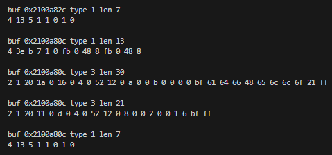

    Looking into mcumgr smp in your github under nrfconnect/sdk-zephyr/subsys/mgmt/mcumgr/mgmt/src/mgmt.c I thought that is the task that communicates with the network core and flashes things but looks like some other task is responsible for that. Now my question is which task/thread/project in this sample project is writing to the flash with the information from the network core? And if you maybe have documentation or API on how this packets are structured for the app IPC task to write to flash. From the log of what is send to the ipc_service_send function in the hci_rpmsg you get information like this:
    And it looks like there is a structure behind the data packets with commands infront with the following data. I would then structure the same packets from the information that I get from ESB and send it through the same IPC process.

    thank you for your information. What I am after here is the understanding of the application core writing to flash or rather how to packetize the binary app_update.bin when received by the network core into a structure which is then sent over IPC to the app core, where the app core then writes onto flash. From the documentation you have sent it says that the application core cannot access the flash of the network core, I assume that the network core cannot access the applications core's flash either. So my question is when I received the binary data in the network core I want to sent this now to the app core, assuming this transfer is being done in the IPC_service, how do I need to structure the binary data and packetize it so when I send it over to the app core that it flashes the new binary?
    In my previous post the second image is a printout of what is being sent through the IPC service. Infont of the packets sent is I assume a command and padding of sorts following the data. When I initiate the firmware update through bluetooth with the device manager android app, you can distinguish that the data sent is the binary file. What I would like to do is use the ESB example for the network core, open the same IPC service, packetize the gotten binary as it needs to be and send it to the app core. I am just stuck at the stage understanding on how to make this packets for the app core to decipher that the sent data is the binary update.
    I am assuming this is the procedure of writing the binary data gotten from the network core that updates the app core. If it is different in fact, please let me know how it is done.
