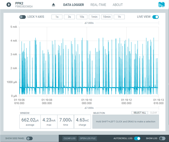

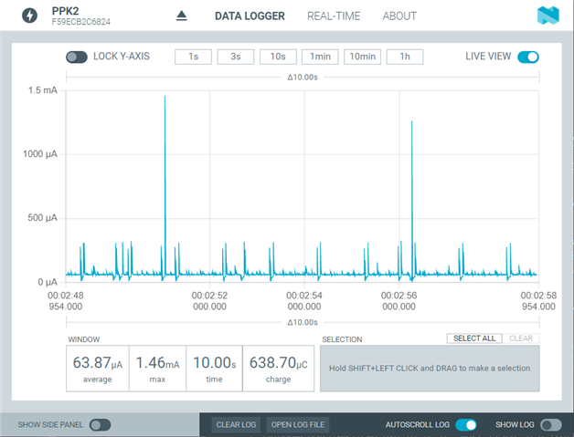

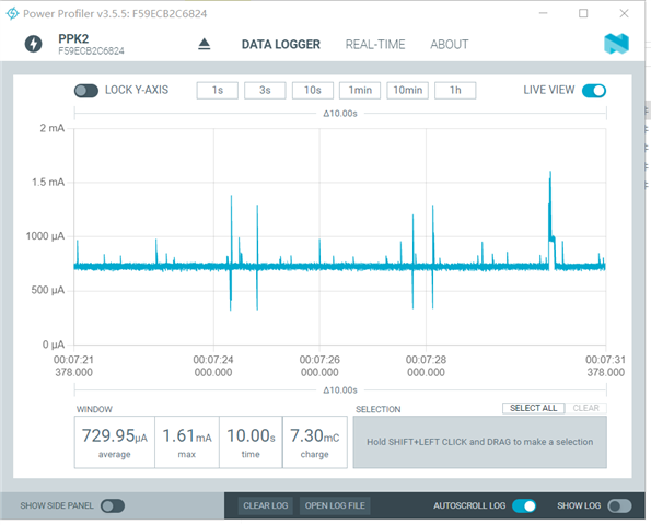

I am developing a product using Nrf9160. Recently, we upgraded the SDK from ncs1.9.0 to ncs2.3.0, and after adapting to all functions, we found that the overall power consumption of the product has greatly improved. By removing some peripheral sensors for comparison, we found that the standby power consumption of the 9160 has changed from 60ua to 730ua. Why is this?
