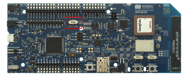

    I am glad to hear that you were able to resolve the build error. The nrfjprog error indicates that you are trying to program a nRF52 project to a nRF9160 target. Did you build the hello world sample for 'nrf9160dk_nrf52840' instead of nrf9160dk_nrf9160' maybe?
    Please make sure the switch on your 9160 DK is set to the correct position.
  • Thank you Vidar,
    The switch position was correct but I had not been careful when I built the .config file and the nRF52... was selected rather than the nRF9160. In the US we call that a "rookie mistake" or simply not paying adequate attention to the software parameters.
    OK, I am up and running. Thank you again.
