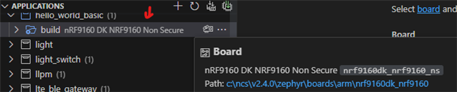

  • What is the target/board in your build configuration on gui in the VS code extension?
    If you're trying to flash the nRF52 on the board, there's a build target for that. (And you need to flip the PROG/DEBUG white switch SW10)
    If you're trying to flash the nRF9160, then there is a different target for that. (As well as a secure and nonsecure target)
    Based on your error, I could replicate this if I tried to flash the nRF52, and the nRF52 was the build target, but the switch was flipped to nRF91 for programming.
    EDIT: I see here that you were able to resolve, and build target was indeed the issue.
    Best wishes.
