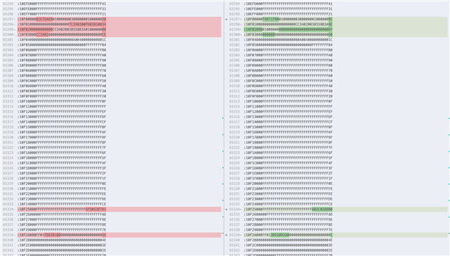

after this line the bootloader goes back to its start. this doesnt happen on every chip though so I dont know whats happening at all.
The flash readings of a chip that works and one that doesnt are identical for my firmware.

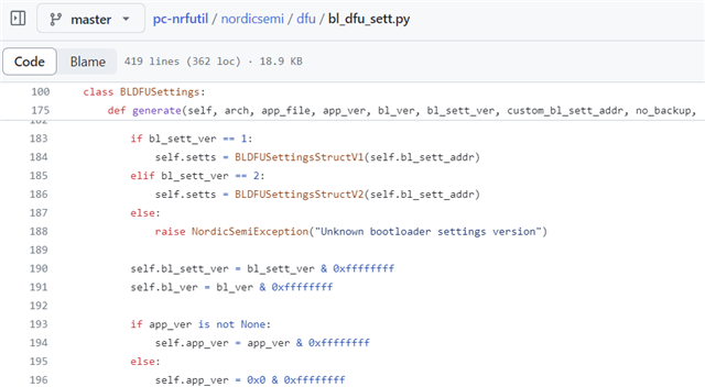

  • actually I noticed one thing, I am using SDK 15.3 and flashed the firmware with bl-settings version 1 although version 2 is recommended. I changed this now but could this be a cause for such behavior?
  • Hi Julius,
    Are you intentionally generating with bl-setting version 1? Why?
    Did you change to recommended version and see if it makes difference.
    I can see is that "Even though bootloaders compiled from an nRF5 SDK 15.3.0 or later can only use version 2, they can be configured to support a version 1 settings page. When a new bootloader with a version 1 settings page boots, the bootloader translates the settings page to version 2 before booting."
    Also, if you want to change the files, then you can remove the assert statement, or do the conditional compilation (if condition then do assert, or the other way around). You can also see if you could / should disable the assertion (as in this ticket).

  • Hello Julius,
    Thank you for your patience.
    I think you are debugging your issue in the right direction.
    I would also suspect that the using different bl-setting page generated by using wrong version number is the culprit here.
    Looking at the underlying code, (python DFU script under the nrfutil), I see that depending upon the version number used, the nrfutil uses a different struct. I also see that bank0_bank_code can be 0x0 or 0x1 depending upon the "app_file". I am not very expert in this, but definitely it looks like something went wrong when you generated bl-settings.

  • I also found the "defective" part in the raw hex from the sensors is exactly at the address that should hold the bankcodes.
    So my strategy now is to go with this approach, make another 50 samples and test them for a week, lets see if the error comes up again, as the rate was around 10-15% id expect it to happen if this wasnt the right fix. Ill get back to you no matter the outcome next week. Thanks for your help though
