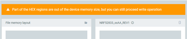

i have already gone through the automated tests which you provide above but in this they provide the hex files which i am not able to flash on the nrf52840.
showing this error could you please help me with proper hex file.
What is the location where you found the hex files? Which hex files did you try to flash on nRF52840? Did you try to flash them to nRF52840-dk or a custom board?
Could you please provide information about the steps you took before you got the error?
Dejan
Hi Dejan
https://github.com/NordicSemiconductor/Android-nRF-Connect/tree/main/documentation/Automated%20tests/DFU%20Tests/nRF52840/SDK%2017.1/output this is the path where i found the hex file . I am flashing this on the nRF52840-dk board .I am flashing this using the nrf connect desktop app --> Programmer

You could try programming using the following command:
nrfjprog --program nrf52840_sdk_17.1_all_in_one.hex --chiperase --verify
Hi Dejans
thanks for the input i am able to flash properly. But for the running the automatic script is there is any proper document because i have read the readme file the lot of steps where not clear to me. which hex to flash what to do next. If any videos could you please provide that.Thanks in advance
