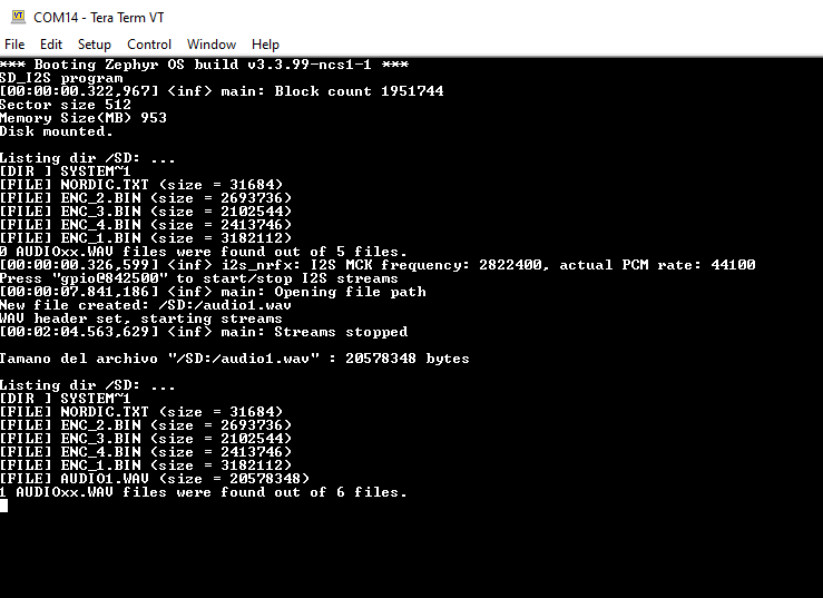

Hi everybody,
I'm using the nRF Connect SDK v2.4.99 and an nRF5340 DK to write data received via I2S to the SD Card.
My application is based on the SDK's I2S echo sample. Both, the I2S sample and the code for writing to the SD Card are working independently. However, when I combine both into one application, my I2S code fails after very short time with the error message: "Failed to allocate next RX buffer: -12" ("i2s_nrfx.c" in line 205).
I was doing some debugging but I couldn't figure out the problem. I'm posting my main.c below. Since I do not want to use any I2S TX device or buffer, I removed all corresponding code from the I2S echo sample. I would appreciate if anybody could point me towards the bug in my code.

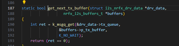

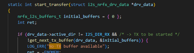

static bool prepare_transfer(const struct device *i2s_dev_rx, const struct device *i2s_dev_tx)
	int ret;
	for (int i = 0; i < INITIAL_BLOCKS; ++i) {
		void *mem_block;
		ret = k_mem_slab_alloc(&mem_slab, &mem_block, K_NO_WAIT);
		if (ret < 0) {
			printk("Failed to allocate TX block %d: %d\n", i, ret);
			return false;
		memset(mem_block, 0, BLOCK_SIZE);
		ret = i2s_write(i2s_dev_tx, mem_block, BLOCK_SIZE);
		if (ret < 0) {
			printk("Failed to write block %d: %d\n", i, ret);
			return false;
	return true;

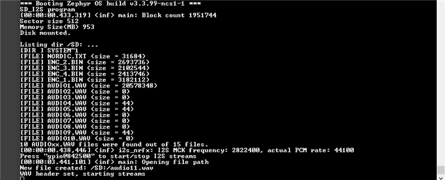

  • I am not able to replicate the issue. Seems like the application is merged OK but I cannot test the functionality of the I2S. Can you give me more details of the SD you are using and the pin connections you have to it?
  • Hi, I am working with him.

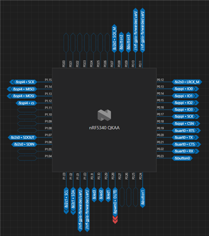

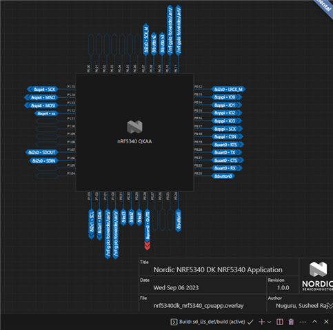

    Here is the overlay file:
    //I2S
    &pinctrl {
    	i2s0_default_alt: i2s0_default_alt {
    		group1 {
    			psels = <NRF_PSEL(I2S_SCK_M, 0, 7)>,
    				<NRF_PSEL(I2S_LRCK_M, 0, 12)>,
    				<NRF_PSEL(I2S_SDIN, 1, 06)>;
    				//<NRF_PSEL(I2S_SDOUT, 1, 07)>;
    &clock {
    	hfclkaudio-frequency = <11289600>;
    i2s_rx: &i2s0 {
    	status = "okay";
    	pinctrl-0 = <&i2s0_default_alt>;
    	pinctrl-names = "default";
    	clock-source = "ACLK";

    I also tried to simply erase the prepare function call in the main and appeared "No TX buffer available" error message.
    Listing dir /SD: ...
    [DIR ] SYSTEM~1
    [FILE] AUDIO1.WAV (size = 196652)
    [FILE] AUDIO2.WAV (size = 0)
    2 AUDIOxx.WAV files were found out of 2 files.
    [00:00:00.514,373] <inf> i2s_nrfx: I2S MCK frequency: 2822400, actual PCM rate: 44100
    Press "gpio@842500" to start/stop I2S streams
    [00:00:03.988,006] <inf> main: Opening file path
    New file created: /SD:/audio3.wav
    WAV header set, starting streams
    [00:00:03.999,908] <err> i2s_nrfx: No TX buffer available
    Failed to read data: -11
    [00:00:05.999,664] <inf> main: Streams stopped

    By doing this the output error is:
    [00:00:10.926,696] <err> i2s_nrfx: No TX buffer available

    Agus said:
    I commented the i2s_write function in the main, and I also commented the line where the prepare_transfer is called. I didn't comment any other line, here is the code of the main file:
    prepare_transfer and i2s_write are needed for being able to trigger the state machine for able to put a message in the message queue as below
    The error that you see is the timeout from the message queue
    The whole thing here is that you are not getting your i2s TX state machine started without i2s_write.
    Your combined main.c file is working fine in v2.4.1\nrf\samples\peripheral\sd_i2s_def\src\main.c
