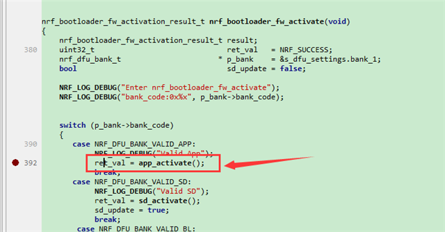

    The bootloader would reset when NRF_DFU_EVT_DFU_COMPLETED event is triggered. This occurs after the write to bootloader setting has finished. On the next boot nrf_bootloader_fw_activate() will be called and if p_bank->bank_code == NRF_DFU_BANK_VALID_APP app_activate() will be called and the image will be swapped.
    My suggestion is to try doing a normal DFU update with the stock bootloader. You then can intercept the process when the bootloader reset, and before it swap the application. You can put a breakpoint inside nrf_bootloader_fw_activate() and check what's the bootloader setting at that stage.
    You then can compare with what you have in your application when you trigger a reset to jump to bootloader for the swap. I suspect that there could be something wrong when you write to bootloader setting, maybe you didn't wait until bootloader setting write is finished ? Or if you don't have the CRC written correctly ? To avoid having to calculate CRC manually I would just copy exactly what inside the stock bootloader setting at the intercept step I described above.
    Actually, I have tried your method. I use the normal DFU to update the firmware, enter the debugging, and let the code stop at the position shown in the figure below to view the changes of the bootloader setting before and after the update.

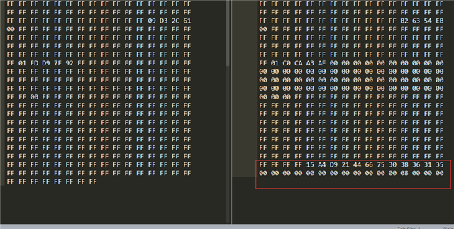

    The figure below shows the changes of the bootloader setting. The left side is the bootloader setting before the firmware is not updated, and the right side is the bootloader setting after receiving all the new firmware. According to the nrf_dfu_settings_t structure, we can know what needs to be changed before updating the new firmware:
    1.CRC
    2. app version;
    2. The bank code of bank0
    3. bank1, including image size, image crc and bank code
    4. update_start_address in progress
    5. boot_validation_crc
    6. boot_validation_app
    7. adv_name
    But after I changed these parameters, I still couldn’t successfully enter the image_copy() function to copy the firmware of bank1 to bank0.
