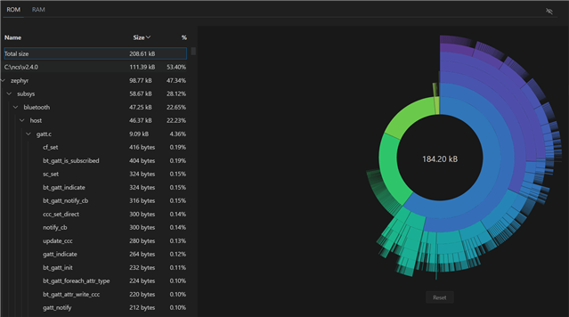

  • Hi
    Sigurd is currently on vacation, and I will help out in the mean time.
    If the flash overflows you are essentially running out of code space, which is not unexpected if you are running a multiprotocol example on the nRF52810.
    What is the flash usage when you have debug options disabled?
    I am guessing you are pretty close to the limit to make everything fit, and enabling the debug options is enough to hit the flash size limitation.
    You can analyze ROM and RAM usage in more detail by clicking the Memory report action in the nRF Connect VSCode interface. Then you will see a detailed breakdown of what the ROM/RAM is used for.
