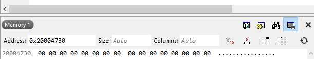

    SES: I was using SES version V7.30. I installed V5.42a and now running some tests. It still gives an error, but this time its a bit more informative:
    Running another test results in:
    I received the "Error reading from memory address 0x20004754" countless times in quick succession before losing the target connection.
    The last message in the debug terminal is once again BLE event: 0x57.
    Please forgive my ignorance, but do you have an idea how I can best figure out the root cause of this memory error?
  • I think there must be something wrong with the hardware on the DK. Either too long USB cable, or something wrong with the debugger.
    Please try to test with another DK to see if you have the same error. Please also try with another USB cable, and connect to another USB port, preferably directly to the mainboard.
  • Unfortunately I do not have another DK available at the moment. I do have a PCB I just received with an nRF52840 on it, but using that could introduce other uncertainties.
    The error I mentioned above is when running my firmware, not the ble_app_hrs example, by the way. Apologies for the confusion.
    I've been running the ble_app_hrs_pca10056_s140 for around 15 minutes now without issue. So it seems the issue is my firmware.
    I am guessing one of my BLE functions is trying to read an invalid memory address, as running just the TWI functionality worked fine.
    EDIT: following this guide from nordic, I made sure I had the right memory definitions. Now that I adjusted it, the same error still occurs but now at a different address:
    Error reading from memory address 0x20004734
