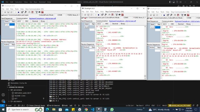

Everything works fine. Both the peripherals connect and disconnect with bidirectional data transfer.

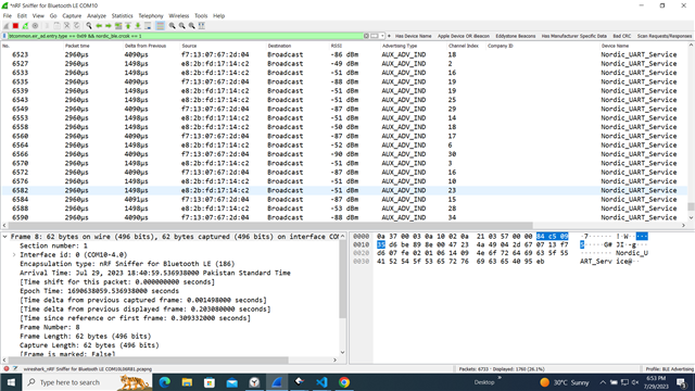

Now the issue I am facing is that,
1) Sometimes 2 out of 10 times, when I reset both the peripherals to connect again with the central, the central device not scanning the peripherals
Although both are advertising as I reset both.
2)To solve the above point, when I reset the central then it connects both the peripherals again and starts communication. Central is not in a hang state because hello messages are seen at the dock light.
3)Sometimes 3 out of 10 times, the custom board (nrf52833) stops communication with the central automatically so need to reset it. But it never happened with peripheral (DK).
4)Is there any filter on the Mac address? .Because the Custom board address starts with F7:13 and DK from E2:2B.malfuncationing behaviour observed with central as mentioned in point #  3

    1)RSSI difference between both the peripherals. DK RSSI is -55dbm and custom -85dbm roundabout.
    E8:2B is DK
    F7:13 is a custom board

    5)When I reset the central the peripherals not advertising, so need to reset the peripherals as well.
    Filters matched. Address: E8:2B:FD:17:14:C2 (random) connectable: yes<CR><LF>
    Connection pending<CR><LF>
    Filters matched. Address: F7:13:07:67:2D:04 (random) connectable: yes<CR><LF>
    Stop LE scan failed (err -120)<CR><LF>
    Create conn failed (err -120)<CR><LF>
    Scanning failed to start (err -5)<CR><LF>

    When this happens, do you see a disconnected event either in the central or the peripheral? You say that they stop communicating. What usually triggers the communication? Is it a timer that times out? is it a button press? Is it a UART command? Are you using bt_nus_send() to communicate? Is that still being called? What does it return?
    I am using the timers to communicate after every 5 seconds, yes I am using the bt_nus_send() to communicate with the central. No, I didn't see any disconnected event either in the central or the peripheral. But I will check it again to confirm your answer.
