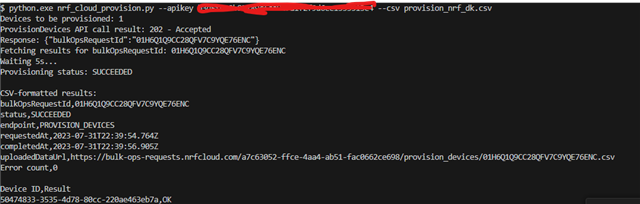

I'm trying to get a GNSS sample working on thingy91 but I always get invalid jwt in the logs output.
The steps I have done so far:
1- updated modem firmware to 1.3.5
2- generate private keys using
AT%KEYGEN=16842753,2,0
3- parse the output using modem_credentials_parser.py
4- create a csv file
 [device_uuid, device_public_key]
5- uploaded via the portal https://nrfcloud.com/#/register-keys
so far no sucess with getting AGPS and PGPS services working using gnss sample.
I'm not sure if I missed a step here.
Appreciate any help!
